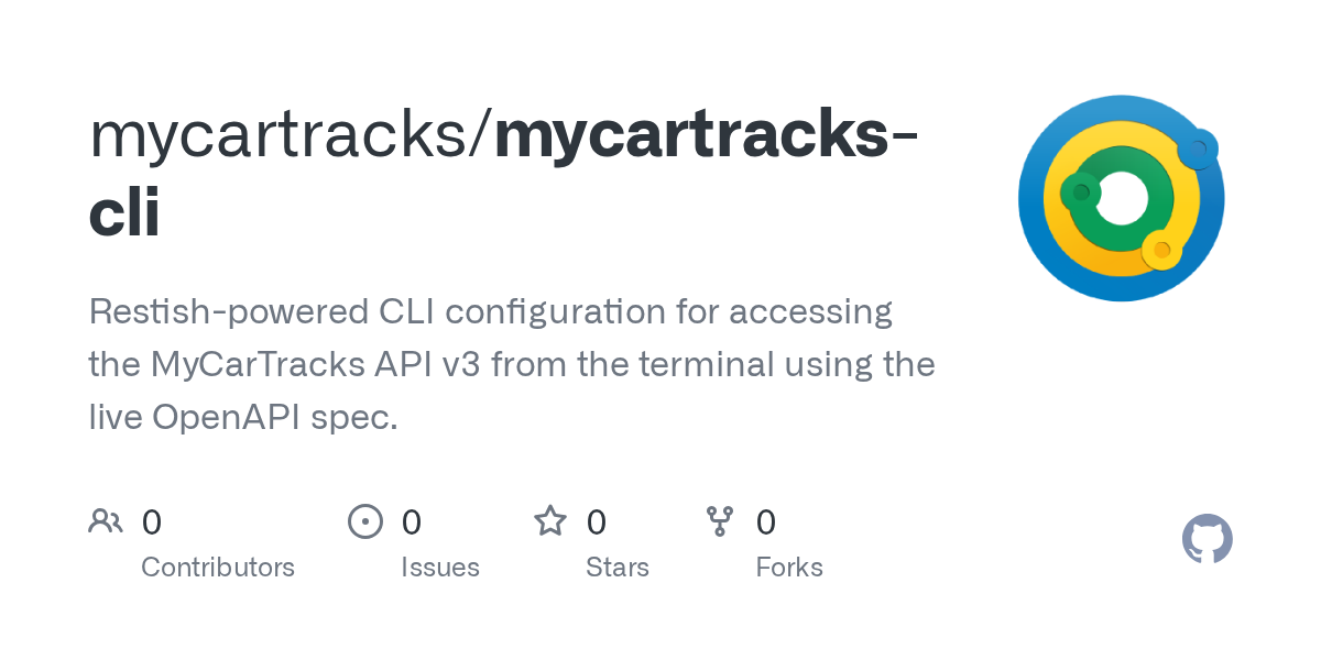

Command-line access
If you prefer terminal access, use the official MyCarTracks CLI configuration:
The CLI uses Restish and the same API v3 OpenAPI document. It is useful for quick tests, exports, automation, and AI-agent workflows.
Read more: MyCarTracks CLI
