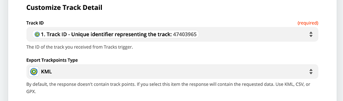

  5. In the Customize Track Details, you need to set the Track ID and match it to the result from the first zap step. Click on Choose value… under Track ID and then click on the tab Custom. Here in the search enter Track ID and select it.
  6. In Export Trackspoints Type select the output format you need (KML, CSV, or GPX).

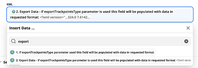

9. Now you’re done. Because you added theFind Track action you will be able to select also exported data in the preferred format, just search for export in the search in data extraction step and select it:
