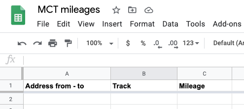

After you have your API credentials and plugin installed, follow these instructions to create an empty Google Sheet for later use:
- Go to Google Sheets and, if you’re not already, log in.
- Create a new blank spreadsheet – for this purpose name it MCT mileages.
- You must add header – Enter column names in the first row, for this example we will add items as on the image below.

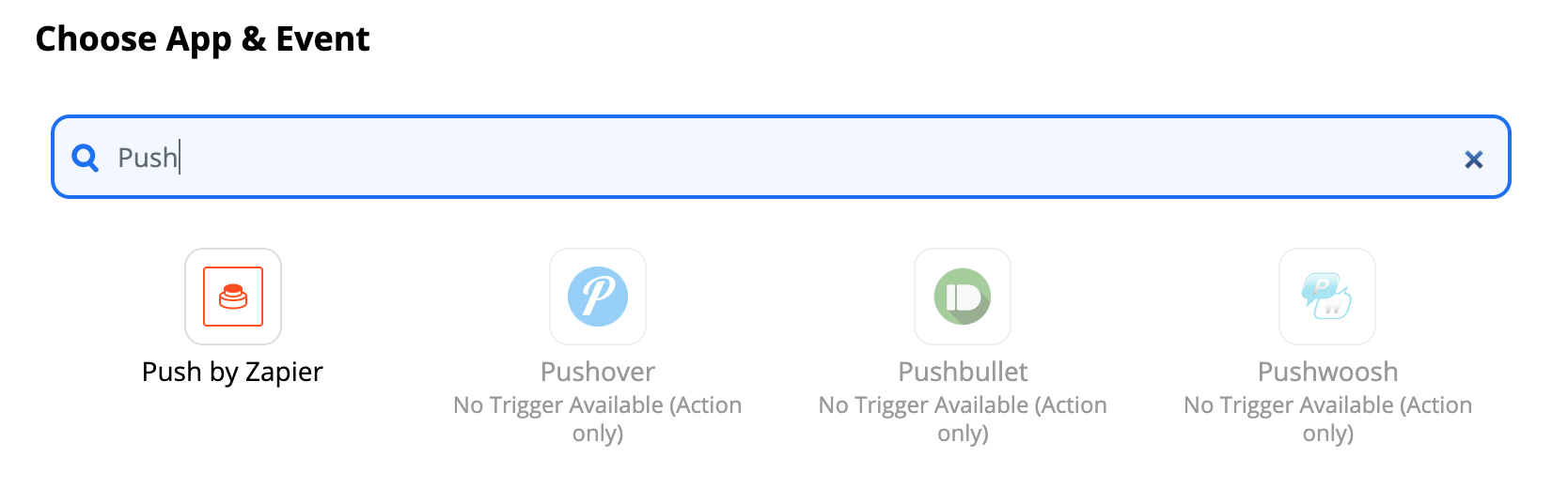

4. In Choose App & Event search for “Push” and select Push by Zapier.

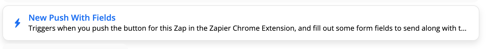

5. Select the New Push With Fields trigger and click CONTINUE.

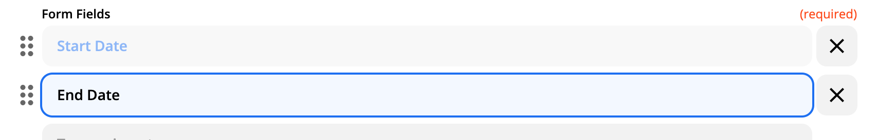

6. In Customize Push enter two Form Fields: Start Date, End Date and click CONTINUE.

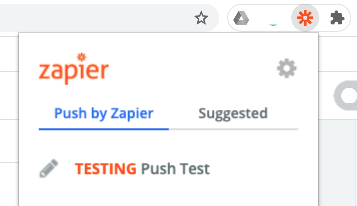

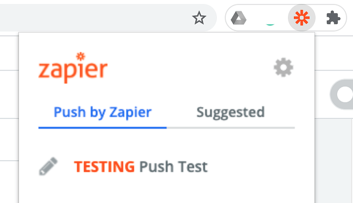

7. Now you need to connect with the Chrome plugin. You should see the Zapier plugin in your extensions bar on the top in your Chrome browser. Click on it and then click on the one labeled TESTING.

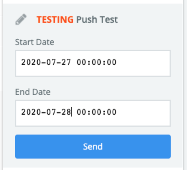

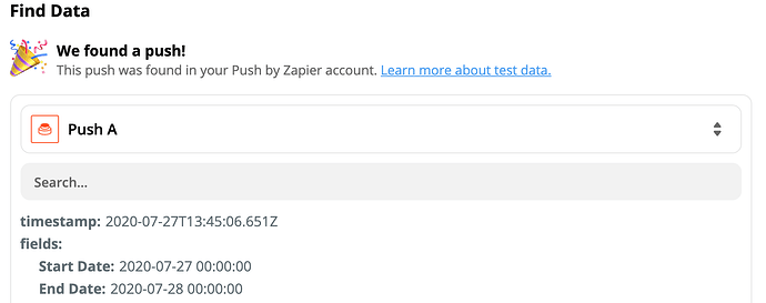

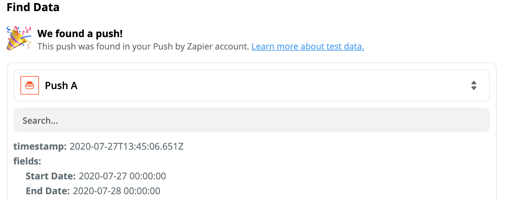

8. Enter the Start and End date. Put it in format YEAR-MONTH-DAY HOUR:MINUTE:SECOND, see the image below. Enter a start and end date that you know there are some existing tracks for the vehicle we want data from. This is just for testing but you need to cover existing data. Later you will be able to set any date you want data for.
Click the Send button. It should show a green successful test.
9. Now back in the Zapier integration click on the Test trigger button. It will show a successful notification that it found the data. Click the CONTINUE button.

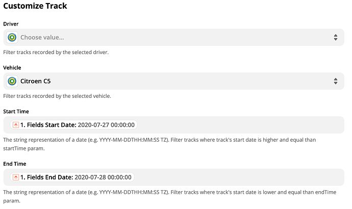

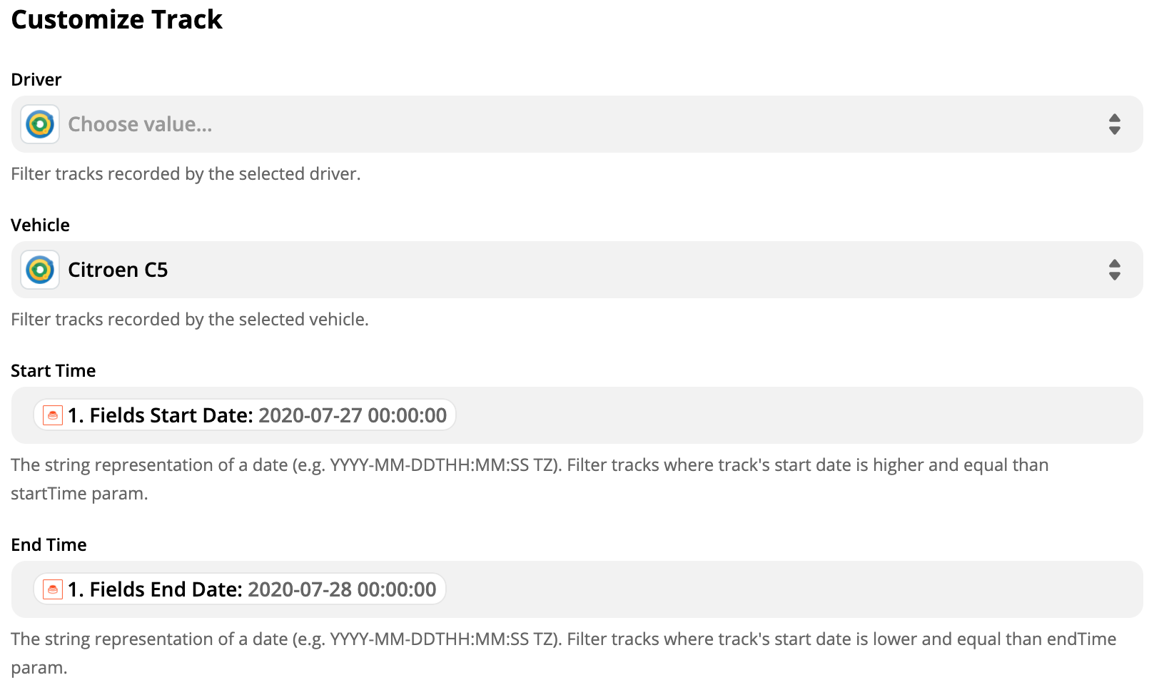

13. On the Customize Track step select the Driver or Vehicle for which you will be obtaining the tracks.

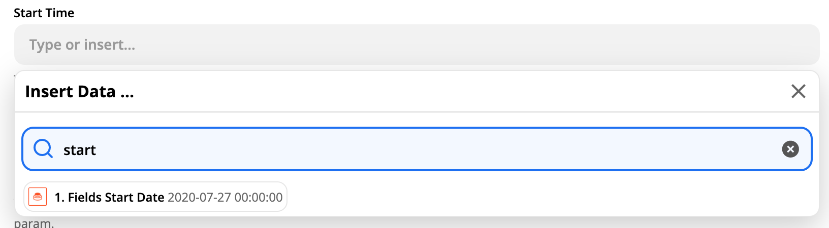

In the Start Time field search for start time and select the Fields Start Date.
14. Repeat the same for the end time but search and select the Fields End Date.
15. You can also use other filtering options if you need them or leave them empty. Click CONTINUE.

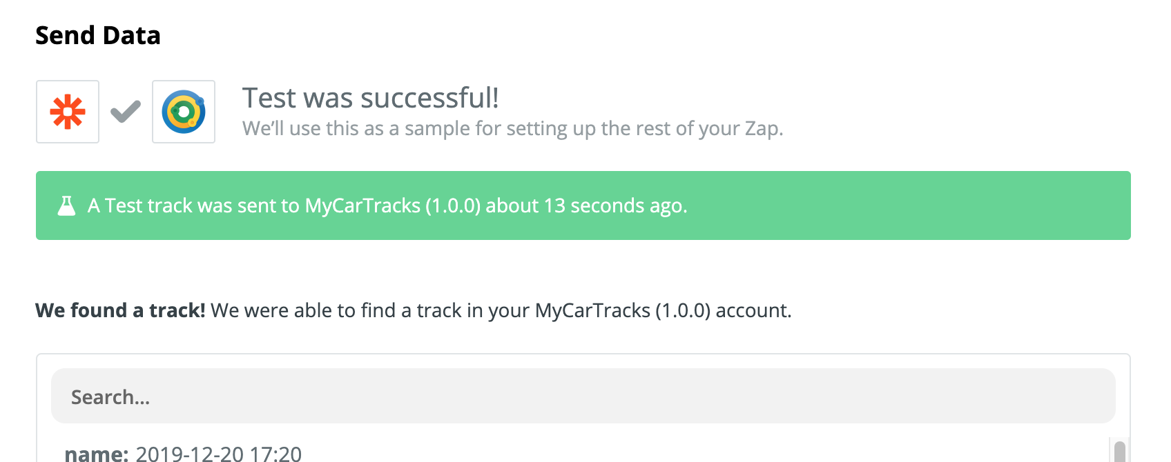

16. Now click on the TEST & CONTINUE button. It should search for existing tracks in MyCarTracks and show you a message that a track was found.

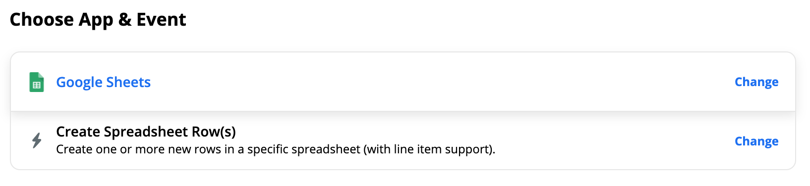

17. Now click on the blue + to add the next step after the MyCarTracks step. Search for Google Sheets and select it.
18. Click on the Create Spreadsheet Row(s) option and click CONTINUE.

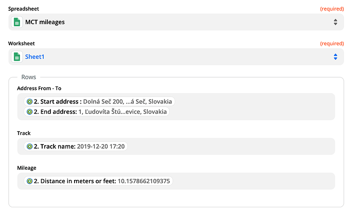

20. After you’re connected search the Spreadsheet (MCT mileages) that you created following the instructions above.

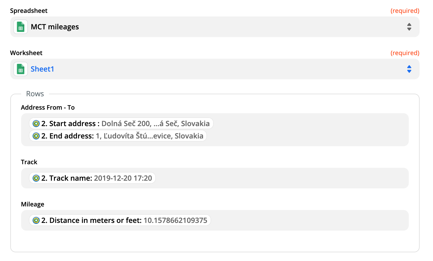

21. Now you need to match the columns from the header with the data from MyCarTracks. Click on each entry and select the correct match as on this image:
22. Click on the CONTINUE button.

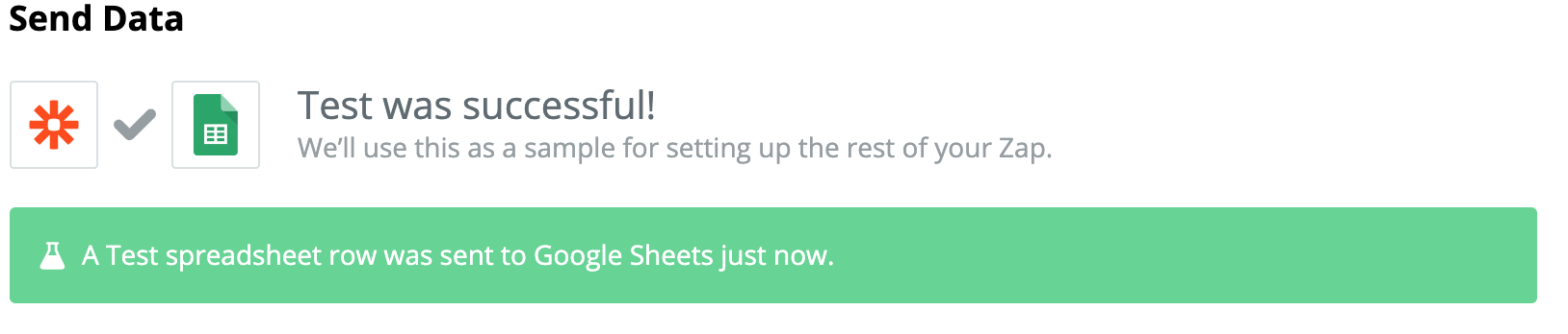

23. Now click on the TEST & CONTINUE button – you will see that a test entry was sent into the Google Sheet. You can remove this entry.
