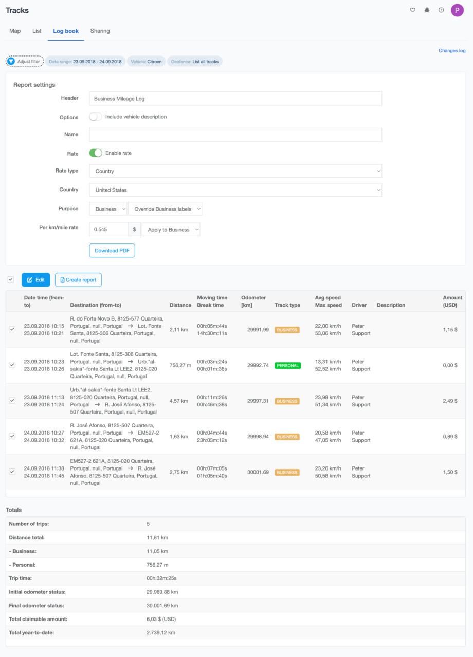

  2. In the left-hand menu, go to Reports and select Log Book.
  3. At the top of the page, use the Adjust filter to specify the date range, vehicle(s), and other criteria. Once set, click Show to view the data.
  4. Review the listed entries. If you need to make any changes, such as editing addresses, categories, notes, or odometer readings, click the Edit button above the table. After making your changes, click Save.
  5. To download your report, click Create Report. A dialog will appear where you can customize the report header, description, and other display options.
  6. If you want to include mileage reimbursement rates, enable the Enable rates option.
Set your custom mileage rate or select from available pre-defined country-specific rates.
7. Optionally, adjust the Purpose field to override individual track purposes in the report (useful for categorizing specific trips like charity drives at different rates).
8. Once all settings are configured, click the Download PDF button to export your report.
