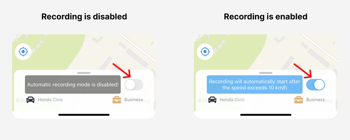

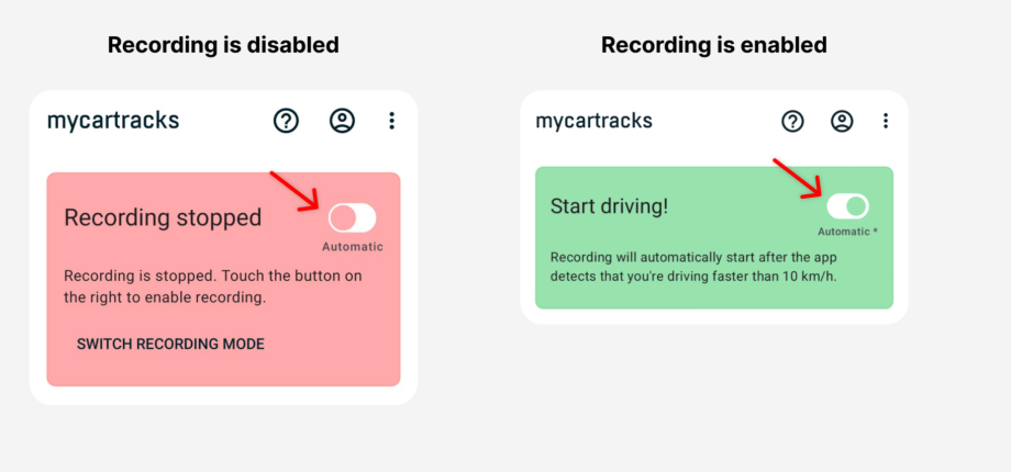

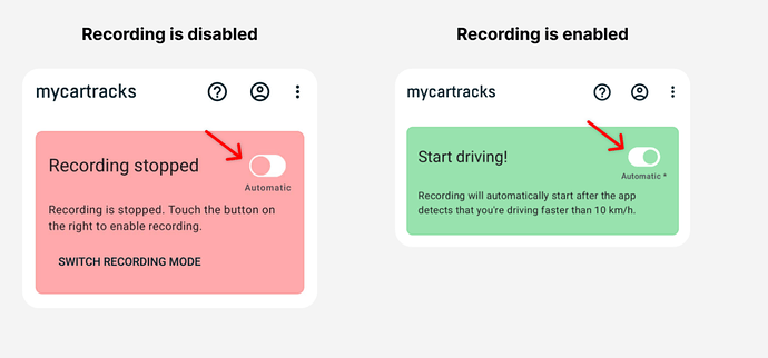

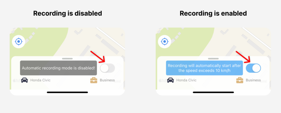

  1. Is recording enabled?
Please make sure that the app is in the recording state.
Android:
iOS (Apple iPhone)

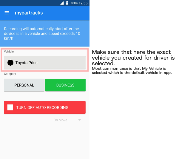

Older Android versions: To start recording use the red button with the START/ENABLE recording label (see below what the app looks like when it’s recording – the button is red with the ability to turn it off). The app also says that it is recording or waiting to detect driving.

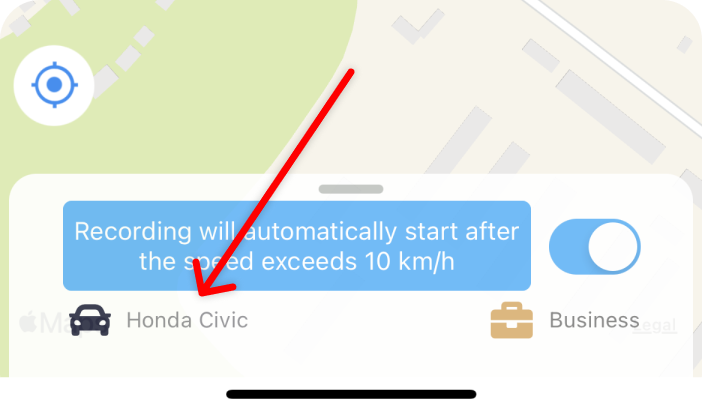

5. Your drivers use the wrong vehicleThis is the most common problem why you don’t see your driver’s data or real-time positions. You create a vehicle for the driver, but your driver uses a different vehicle (most commonly the My Vehicle). Make sure that your drivers have selected the right vehicle when they are recording tracks. See these images:
Android:
iOs (Apple iPhone):
To change the vehicle ask the driver to tap on the vehicle name, and select the correct vehicle.
