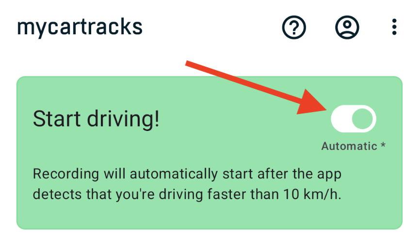

  • Go to Menu / Work Hours and turn on the option Use work hours. After that touch Work hours action and select Enable selected recording. Now touch Set days and times and make sure to enable all days (or days you want to track) and select the time from 12:01 AM to 11:59 PM for each day.
  • Now go back to the app’s main screen and touch thedisable recording button.

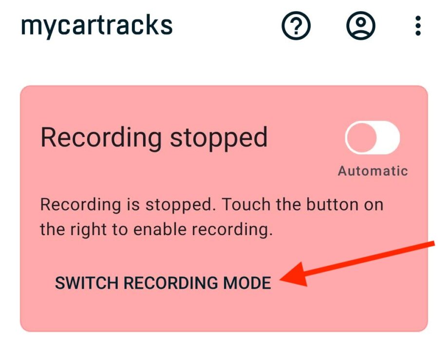

By doing that a button SWITCH RECORDING MODE appears.
Touch it and select Manual. Now touch the START RECORDING button. This starts recording and will record until the stop recording button is touched.
